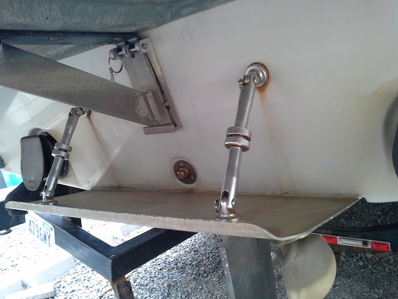

More direct drive thoughts:
Another thing that come into play for us is the wake plate. Mine has no hinge and is adjustable to the extent of how much you can crank it down via the turnbuckles. When I bought the boat, the prev owner had it all the way up. as I started adding more ballast, I found that I would porpoise REALLY bad when surfing. It was to the extent that I was running out of power and the steering was feeling really hard. I ended up putting the wake plate down by maybe just 1/2" down. You can get a good look at it here:
Before:
After:
It really changed things up. Steering input got a lot easier and I regained that lost power since I wasn't pointing my prop as down in the water. It's yet one more variable to play with. I really wish I had a power wake plate to make adjustments more on the fly and more easily see the outcome. But it's another thing to think about.

You should call up Bennett or Lenco and see it they have a replacement for that fixed tab. I can't imagine not having one. I use mine constantly.
