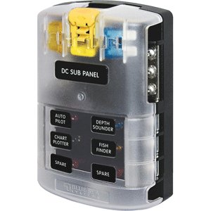

Old    Shawndoggy (shawndoggy)      Join Date: Nov 2009       05-28-2012, 6:36 AM Reply
something like this?
http://www.amazon.com/Blue-Sea-2300-...ata/B000KOR7DE
Old    Shawndoggy (shawndoggy)      Join Date: Nov 2009       05-28-2012, 6:41 AM Reply
I have one of these:
http://www.amazon.com/New-BLUE-5025-...212284&sr=1-40
The relay provides the power to the fuse block and I pull ground from the stereo battery. Then I can use it for the amp turn ons and also to power small stereo-related accessories like an ipod cable, bluetooth unit, etc.
