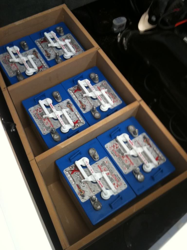

So I got started on the 2 Battery boxes the would hold the 12 Battery's
This is pretty much how the battery's would sit in the boat.
I took the Boxes and had them Rhino lines and added the doors. Jason still wants to be able to have the factor ballast bags sit on top of the battery boxes. They needed to be strong enough to have a 300 Lb bag sitting on top of them
Old    Joe (ilikebeaverandboats)      Join Date: Jul 2007       04-17-2011, 11:57 PM Reply
sweet man. why no angle iron or something to make that thing a bit stronger?
Old    "G" (grant_west)      Join Date: Jun 2005       04-18-2011, 7:52 AM Reply
These boxes are super strong.Tight tollerances wood glue and screws make these boxes pretty bullet proof. I had built a sub box that we later took out and tryed to destroy. I was very supprised at how strong the box was. Unless the boxes got water into the wood these things are just fine..

Ditto guido, thats 420lbs of batteries + box (40 lbs?) PER SIDE!
Looks great G! Although, wont changing the oil fiter be a little tough?

Adam: It has a remote oil filter so changing the oil is no problem. But I know what your talking about. I had to take the starter out and had to remove the battery box. I had the battery's out and box out in under 15 min's so its not that big of a deal if you need to get to the side or under the motor.

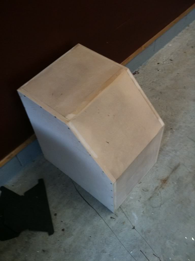

So with the Battery's taken care of I started working on the Sub box's. Like I said above I was pretty much at a complete loss at what to install in this thing. I started asking around "What would you install" to all my stereo buddy's. Boat's are so diffrent. The same system in one boat can sound completley diffrent in another boat. Example I have re-done the system in my boat like 5 times to get it where its at. When installing a system for a friend or customer you don't want them to be "the learning curve" or be working on their boat off and on over the next 5 years to get it right.
I kept hearing how well the X-Star's Ryan (Chucktronics) had done sounded. So I decided to to in-list Ryan's help in laying out a system for this boat. I had heard great things about the CIE boat and Blake's X -Star. I knew I wanted to run "4" 12's but how or where was still up in the air? Ryan sent me a few pic's of the "4" 12's he had done in the other X-Stars and I decided to copy his system layout. "Thank You" Here is how I got started.
I made a Small (But to scale) cardboard template to see how the wooffer's would sit in the passenger compartment.
The tape on the floor is the out line of the area the box will take up. Mike Ski was nice enough to calculate the air space and size for me so I got started on the boxes
After I cut out the holes for the subs the space where the subs almost touches got pretty thin. I had to add some extra bracing to add strength after I was finished it was real strong in that area.
The Boxes came out real nice. I will post some pics of them in a few hr's

Sub Box's
Old    C.I.E..... Evan (guido)      Join Date: Jul 2002       04-18-2011, 1:54 PM Reply
Nice. Sub boxes look great. The 4-12's worked awesome in our boat and still left plenty of room for gear, etc.
